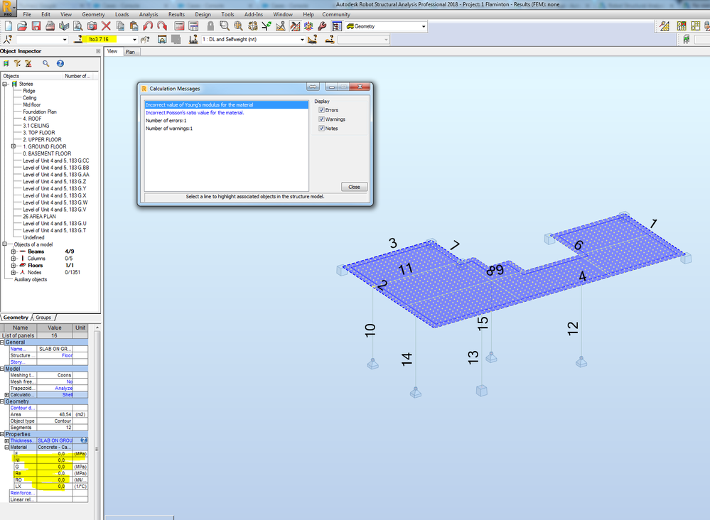

Hi Autur,
I can not analyse this structure neither by Required Reinforcement nor Provided Reinforcement method,
please take a look into the model attached,

Hi Eric,
Check the material you assigned to elements of the model
