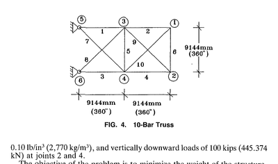

Hello everyone,
I am currently working on a project and encountered a discrepancy in the self-weight calculation of RSA . The self-weight computed by RSA is higher than what is reported in literature studies. I also manually calculated the weight using the length and unit density, and my results matched those in the literature, but not the RSA results.
Has anyone experienced similar issues or can explain why RSA's calculations might be higher than expected?

I did as you said. Could you try running this file ?

the difference (5620/5734=0.980...) seems to correspond to gravity, are you sure of your comparison, of the densities and sections taken into account in your example, a mathematical simplification?

I double checked everything. All the parameter are same except the calculated weight.

Could you comment on this table and tell us what evidence you have in relation to your verifications?
can you give us the value of the density you include in your calculations?
↑ the sections seem to be the same ↓
Without a comparative list, I can't check for myself.

Here is the original structure and corresponding parameters from paper:
And here is my python results:
By the way, all of the  displacement and stress results matches for two model except the weight.

if all lengths and cross-sections are identical, do you agree that density
is not equals to
As Explain, the difference (5620/5734=0.980 ... 5734/5620=1.02) seems to correspond to gravity !

it's a mathematical simplification in your example. the true value is the one calculated by Robot
