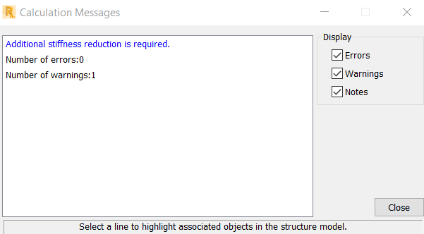

I've made releases on beams, ticked on DLC and the calculation shows that Additional stiffness reduction is required. Is it Tau_b coefficient?
Also the results for moment for the beam (on the roof) shows 85.02kipft for DAM - COMB1 + NL X+, while in the AISC design guide 28 it's 2580kipin.
Message 10 of 55
HoshangMustafa
I set beams 25 and 27 to be Ry released in Beginning and End. The results seem to be reasonable. Only one issue with required additional stiffness reduction. Any help would be appreciate.

Hi @HoshangMustafa
I have registered question about warning about necessary reduction is reported in Developers Database (ticket RSA-39177). Warning disappears when option "Add additional loads" is selected (instead reduction 0.8 for steel elements)
Bending moments in beams are bigger than presented in reference table, (for COMB1) when structure is calculated without DAM,  After adding notional loads in DAM moments cannot be smaller.
I understand that after model modification (described in message 10) you have obtained reasonable results for moments..
Krzysztof Wasik

Hi @HoshangMustafa
Using additional loads is workaround I can propose to avoid warning about stiffness reduction. I am waiting for explanation regarding this warning.
Krzysztof Wasik
