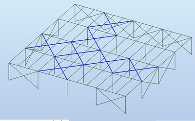

I have a building consists of two full area (352*462 ft) mezzanine floor
the system is a steel one way decking, released main beams and joists and the decking supposed to transfer the lateral loads to the braced frames for the 4 outer elevations (all supports are pinned)
as per the attached snapshot also i attached a simple model that i face same problem in define this concept
i tried the rigid link , panel calculation model (membrane) also i tried shell with a custom definition with 0 bending and shear stiffness i really get bored so please help.

Hi @omarsQSKVQ
Just add some horizontal bracings
Model attached

Do you think i need to add horizontal bracing "Is it a must? "
or the composite slab work as a diaphram to transfer the load to the vertical bracing
the attached snapshot from Design Examples  (AMERICAN INSTITUTE OF STEEL CONSTRUCTION)
is it the same system ?

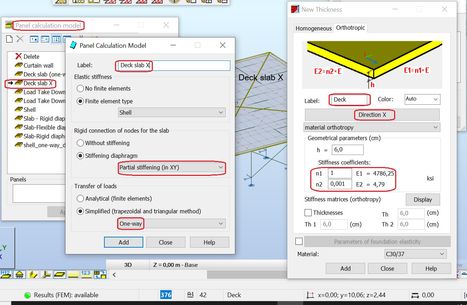

Another solution is to use an orthotropic slab of thickness equivalent in weight to your one way deck.
Here, i assumed your composite deck have a SW of 1.5 kN/m² then equivalent to a 6 cm thickness orhotropic deck.
Model attached

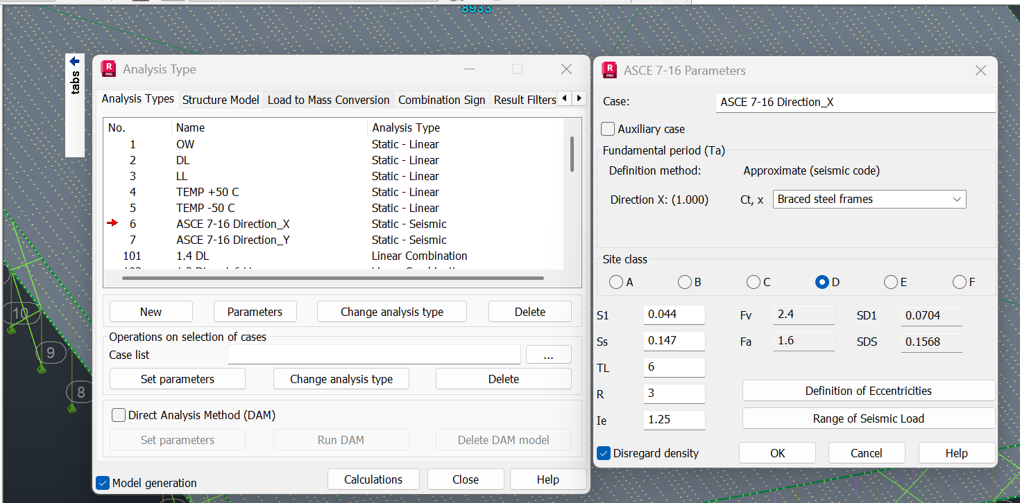

Hi @omarsQSKVQ
1. Pinned -Pinned release ( only Ry ) .
2. Remove the click from (Disregard density) since the self-weight is excluded from mass participation.
3. Delete duplicate case (6) from the converted cases
4. The modified file is attached.

For the seismic mass participation  definition, Is it okay to define it as per the attached snapshot?
and one more question, I don't need to define panel thickness aright?
I think whole the trouble because of the wrong releases definition.
really thanks again.
Message 7 of 8
Refaat
Hi @omarsQSKVQ
Yes
Possible if diaphragm is used as well the slab weight considered as uniform load . Define the slab thickness is more preferable.
Certainly
