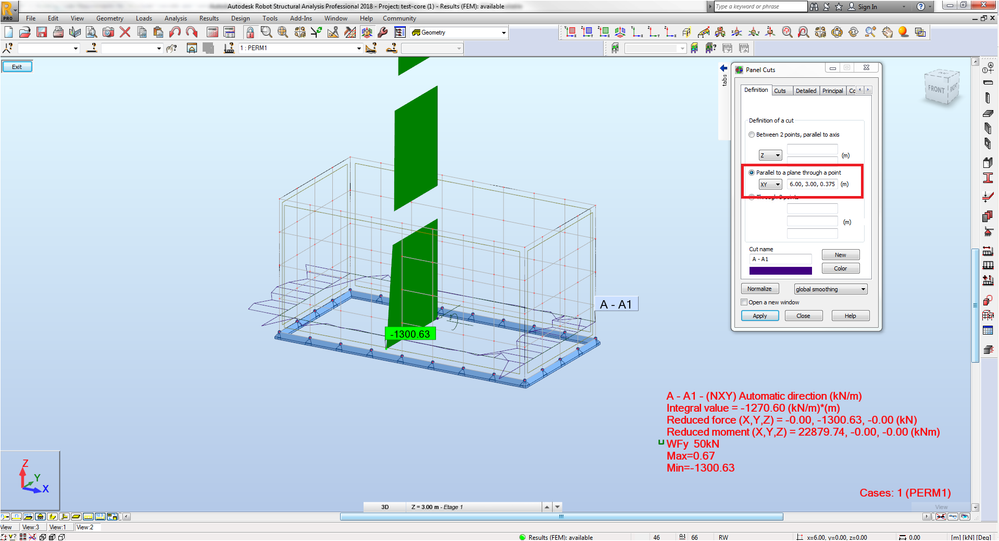

     1- I guess values on diagram are given the same way as on a panel cut or reduced results. Probably they choose the center of the last row (up and below) of FE to avoid conflict regions that always appears near de edges of each story where the incoming  slabs get their support.
Setting panel cuts on 0.5m and 7.5m height , will give the same values found on core wall diagram
FE method will never give you a 100% correct result. But of course if you refine the mesh, results will get a LOT better. For a 5cm mesh size both models give an almost perfect moment at the bottom.
And if you assign the horizontal loads on the middle of the wall instead of the corners , results will be a lot better also on the upper side of the wall

Hi @mustafahesenow
Rafael is 100% right. Initially (in older versions of RSA) the cut to obtain values for the core wall diagram wad made very close to the panel edge (you can find some complains about this fact on this forum Smiley Happy) but the results obtained in this way were by far less accurate comparing to these done at the centers of the first row of surface elements so the corresponding change was made.

mustafahesenow
Hi @Artur.Kosakowski @Rafacascudo
I know That the reduced cut forces will have big variation base on mesh size and shape.of the mesh .But If you tried to consider square mesh You will obtain good result with good accuracy For the panel Cut result At Any place You make Cut and this will make this issue more practical.
But By Having the result from Core wall on center of mesh up and down this mean that this core wall result is useless because you cant obtain the bottom moment of each level and the result will be more far from the actual and  this will be un trusted and not safe to design the core wall base on the core wall result diagram .There fore we really need to understand why cant the core wall results cant be obtained  at top and bottom level though we know that its easy to have cut for the core wall on the top and bottom by panel cut and get the accurate result.
Just to let every body understand my point I will give example:
If Have tower with core wall and with 4m story height for functionality and practicality reason we use mesh with as 1 m Square type means that the result of the core wall will be given on the base at 0.5 m height from the base level and this will be not correct at all and suitable to design the core wall.
Mustafa Hesenow
Senior Structural Design Engineer/MZP
LinkedIn
Message 5 of 44

Hi @mustafahesenow
I wish that was true Smiley Sad
Please check: https://forums.autodesk.com/t5/robot-structural-analysis-forum/core-non-consistent-results/m-p/45281...
This is indeed a valid point so you may consider the following options:
1. Freeze the mesh and moving most top and bottom nodes of the 2nd row of surface elements surface elements closer to the panel/wall top and bottom edge
2. Select the outermost rows of surface elements of core walls and use mesh refinement option
I hope you find them helpful.

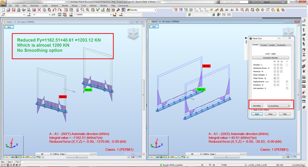

mustafahesenow
I did Research about this issue and I found that there is mistake When RSA calculating The reduced result of panel cut
For the same example of the core wall the one you where showing me The Rsult which is related to link
https://forums.autodesk.com/t5/robot-structural-analysis-forum/core-non-consistent-results/td-p/4528...
I took the lower core have walls no 1 2 3 4 then I made section which exactly at finite element center z level 0.375m as shown in the picture :
I study this section in order to know what is happening because I am really not believing that this error will be encountered in finite element method
(Result bigger than Actual)
The study is came first by studying the way RSA Calculating the Reduced result attached in this link
http://help.autodesk.com/view/RSAPRO/2018/ENU/?guid=GUID-2C7F8C26-C452-46A3-9A0D-07C9B278233A
Then I did this steps in order to understand :
I changed the X local for the walls to be according Z global axis  then I make model calculation I study case no 1 Which the reduced result of Fy is 1300.63 Kn which bigger than the force 1200 kn .
Because this core is symmetric so I took each two paralleled walls individual Then I compared it with the whole.
I took the 2 walls no 2 and (this 2 walls are parallel to Y ) in a window then I view the section Nxy :
Because that this 2 walls are parallel to y So :
Reduced Fy = integral value of Nxy of the map cut But RSA doesn't calculate it correctly see the picture :
So Fy=1111.51 KN Not 1270.60 KN.
I took the other 2 wall no 1 and 3 then The two walls are perpendicular on the y direction So
The Reduced Fy force = integral Value of Qz (shear force not membrane)
So Reduced Fy = 8.79 KN Not -30.03 KN
There Fore The Total Core Wall Reduced Fy Force
Fy = -1111.51+8.79 =-1102.72 KN
Not 1270.60+30.03 =1300.63 which same core wall result.
There Fore I think Everybody know why this Error encountered .
@Artur.Kosakowski awaiting for your feed back.

Hi Mustafa,
IMHO you need to consider the direction of shear in (perpendicular) walls and mind the averaging settings.

Rafacascudo
Hi Mustafahesenow ,
The difference is that you are getting results using "global smothing". If you choose "smoothing within a panel" instead , results will agree with those found on "diagrams for core walls".
So probably , "diagrams for core walls" is using that setting ( smoothing within a panel") to achieve its results. Maybe it would be a good idea to bring this choice of settings (no smothing , global smoothing, etc) also to "diagrams for core walls" dialog window.
Rafael Medeiros
Message 13 of 44
mustafahesenow
Hi @Rafacascudo @Artur.Kosakowski
1-With considering No smoothing we will get Accurate results
2- With Considering Global Smoothing
2- With Considering Smoothing  within the panel
There Fore The Best option to calculate the reduced Forces and moment for panel Cut and need to be implemented on core wall result from
top edge and bottom bottom edge is Calculation this Values base in Global smoothing cut option .
Because If we make cut on the base of the core wall we will get this result :
Please @Artur.Kosakowski confirm it and Let it be modified.
