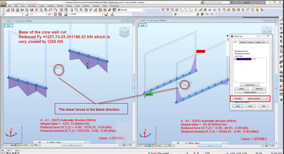

Hi @mustafahesenow
The global averaging is IMHO ruled out. Mind that by using it you will include any 'additional' panel attached to the core wall in the equation and it will also influence results by adding up 'different' forces (imagine automatic direction and neighboring panels with different direction of local X axes while you open one of them in a new window to see only these results.
In your example this even changed the sign of forces:
Artur Kosakowski

Hi Mustafa,
Thank you for your reply .
1. But do you think that is correct . The two shear forces (Nxy & Qxx) could be in the different directions since you have only supports at the bottom of core wall and all walls have the same stiffness as well all forces in case (1) applied on the core wall purely in one direction.
2. Why did you consider the sign of (Qxx) while as didn’t consider the sign of (Nxy) ?
3. As you see in the capture below (Artur’s capture) he added both forces and he used reduced forces instead of integral value since in some cases are not  same values.
Thank you
Yes this could be especially its finite element core and the result above show you that the integral value of QXX Comes sometimes +sign and sometimes - sign depends on the smoothing option the one you use any way it is small value so its still acceptable.
 It is considered and its related to automatic direction of the panels which is opposite of y global direction.
Look at all the diagrams posted by me or Artur you will see the integral force of QXX  have different sign So sometimes to be added and sometime need to subtract .
Anyway The QXX value ir really small compared to Nxy what is the important is That total value of reduced force should be very closed to actual not far.

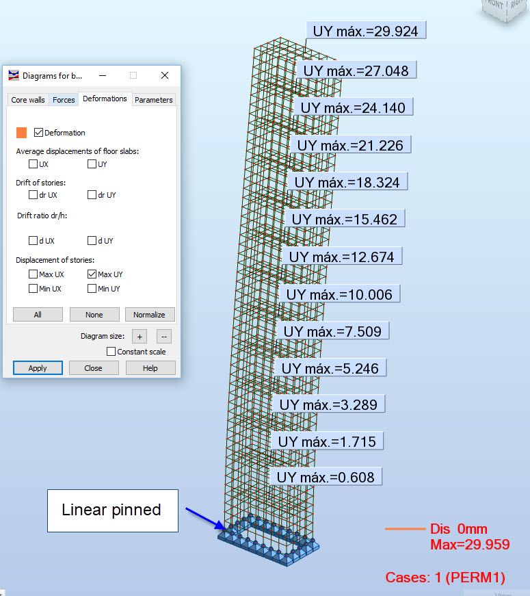

Hi Mustafa , Artur , Refaat ,
As I only have an idea of how the program works ,I like (and need) to experiment . What really caught my attention on this thread was the very wrong ,almost 10% error (although on safety side) on the value given for FY by "diagrams for buildings" . It was supposed to be 1200kN and the result given was 1300kN.
For the original file , MX result is 2.2%(against safety) wrong which I say would be somewhat acceptable . Perfect result would be 23400kN.m

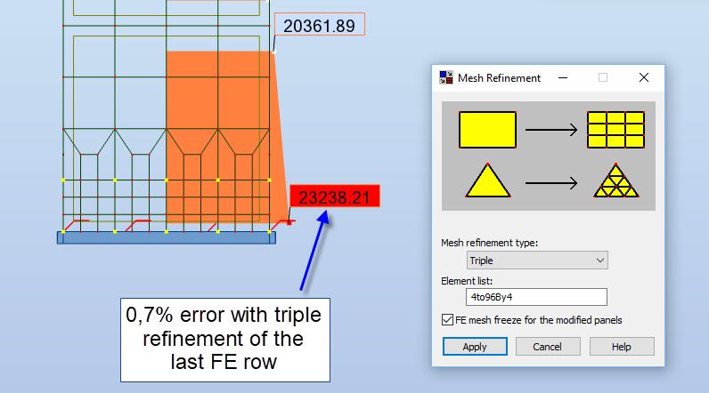

Triple Refining ( this fixed model) only the last row of FE´s gives an almost perfect result with only 0,7% error. Double refinement would give a 1% error
 Which for me would be a pretty acceptable results!!!

Of course there´s the argument of changing the linear support from pinned to fixed. But in fact the difference is very negligible because even with pinned support the "fixed" effect is given by the restrained core wall  retangular "section" . Comparing the Y displacements among the 3 different models this becomes evident.
As expected, linear fixed and fixed central node with rigid links give they same results .

mustafahesenow
Hi @Rafacascudo
You are very right about the support type.
But For refining the meshing I believe this is not practical because the core wall is not designed and one uniform section with base reduced forces.
Sometimes walls stops at certain levels . Sometimes thicknesses of walls change at certain levels.Sometimes there are outriggers connected to the core at certain level. Sometimes Designer want to change the reinforcement every few stories.
Do you think this easy for such core wall (this is only connecting elements in one section and there are many from the other sides )

Rafacascudo
@mustafahesenow
Of course nothing is easy on a model like this giant building , but if you require such a precision , then you should try refining the mesh, at least , at the important spots.
I am pretty sure you are very able to do it fast and correctlySmiley Wink
