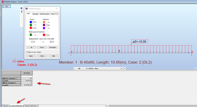

There are several ways to check deflection. For this simply supported beam with a uniform load:
1. Default settings:
2. By adjusting the number of division points in the table view. By default, Robot reports results only at the beginning and end of the element.
3. Using Detail Analysis menu without changing the number of division points also may lead to mistake:

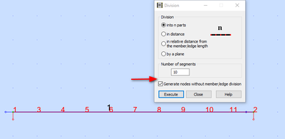

4. You can generate nodes along the beam using division of the bar element:
