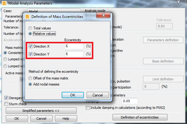

For example, in the code of my country (Venezuela) accidental eccentricity of 6% should be defined as follow:
Due to the code is not in RSA, I need to set a Modal analysis and then a Spectral analysis. Now I've read that the eccentricity should be introduce here:
I read that selecting Add nodal masses is more accurate.
But now, I need to define eccentricities in positive and negative directions. I usually do this defining a moment Tx = Vxi x 6%By (X dir) and Ty = Vyi x 6%Bx (Y dir) and then adding these moments in 2 load cases (Tx and Ty), then I combine these cases with the seismic ones in several combinations. For example:
See that when 100%Sx is acting also act Tx and when 100%Sy is acting also act Ty, and then changing signs and so on so on. Of course I want to know if its possible to do all this work with RSA. I think the answer is YES but how? I read something about define 4 modal cases and define something like:

Hi @Anonymous
In Robot there are two ways of defining eccentricities.
When you define it in the modal case you calculate it with the shift of masses so depending on the defined directions of eccentricities you will obtain different shape of vibrations. This approach requires definition of several modal cases one for each of the directions of eccentricities you want to include in the design.
When you define it in the seismic case (not available for a spectral analysis) you can have only modal case however as it is the 'simplified' approach the following points apply:
1. The modal analysis performed is not exact since it does not take into account the mass eccentricities. Therefore, the mode shapes are not the same as calculated with mass eccentricities defined for the modal analysis case.
2. The eccentricity of the mass is then considered "statically" in order to get the forces in the members. Therefore, the forces in the members are not exact.
3. This method provides the same base shear for all eccentricities. Only the values of reactions in specific supports are changed but the total base shears remain the same when changing eccentricities. So for instance for symmetrical building if the mass eccentricity is making it unsymmetrical the earthquake in X direction will still result in 0 base shear along Y and vice-versa.
I hope this helps.

Hi @Anonymous
As it has already been mentioned for spectral analysis you can only define eccentricity in the modal analysis parameters Smiley Sad
Artur Kosakowski
