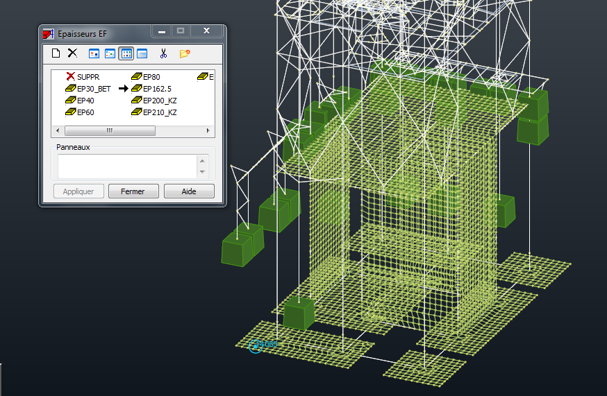

Q1: I received a model from an engineering bureau created using Robot2016, while opening the model with the same version of the software I get an error telling me that the software was created with a recent version of the software. I don't know why I get this error.
Q2: In the model I find finite element mesh but not the panel assigned to this mesh, how can I create a panel from this mesh.
Thank you in advance for your help. Ask me if you need more information.
Select the elements of the mesh and use them to create a panel in the way shown below:
