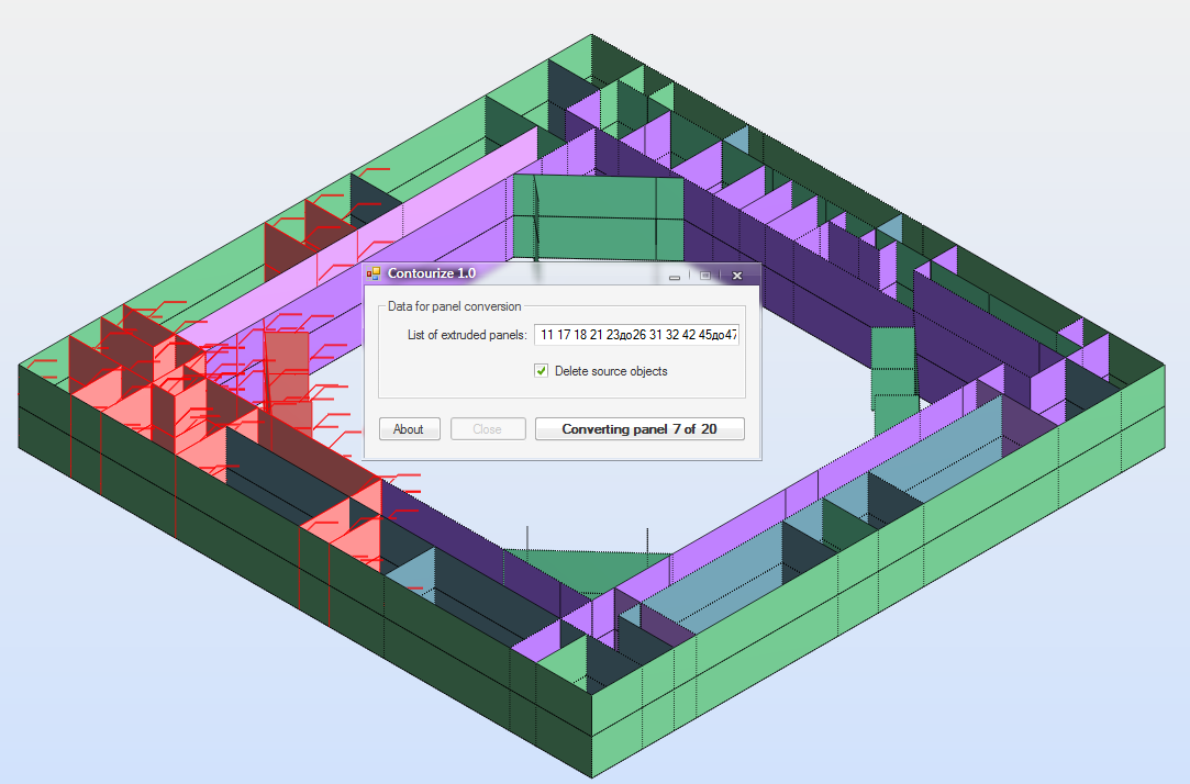

Contourize is an add-on for Autodesk Robot that converts panel objects generated by the Extrude tool into normal contour panels.
Major advantage of contour panels over extruded panels is that they support all normal meshing options. Extruded panels can only be meshed as s simple strip of rectangular elements.
Panel thickness is preserved even if defined indirectly as default thickness during extrude (not shown in object browser). Loads and meshes are not processed, use it before any load definitions.

Example:
1. Select objects and activate add-on window to update selection.
2. Launch conversion procedure.
3. Result: note the contour lines drawn on panels that are absent on extrusion objects.
