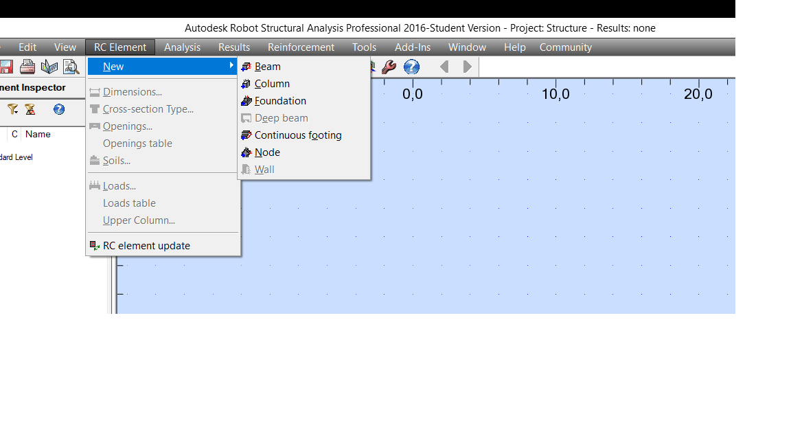

I first tried to open the RC Elements Design, but the option "Wall" under new RC Element is not available.
Could I use other modules if this one isn't available?
Thanks very much in advance! 🙂
PS: I'm using EDUCATIONAL version at home. Is that why Wall isn't available?

Sadly, I get trouble when going from the design module to the RC inspector. I'm attaching pictures. It seems like it automatically goes to BEAM, not wall. I also get a design code error...
Maybe the Wall Design ain't possible with the Student version after all? I tried searching it, but couldn't find anywhere in the Robot documentation that says this isn't possible with the student version. Up until now, I've felt the student version has full functionality.
If I define the wall as a panel, it's imported as a slab. But I can't see no wall. Third picture attached.

Hi @Anonymous
Mind that the RC Wall module is available for French EC2 (NF EN) and ACI codes only.

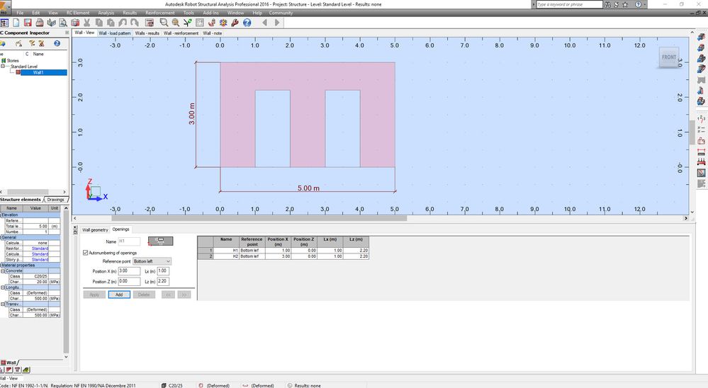

I haven't been able to look into this until tonight, but managed to get a step further now, I think. 🙂 I have now been able to export the wall to RC Design and actually have it recognized as a wall.
1. Design code
I did change to the French EC2 and that might have done the trick.
What I meant Artur is that Norway and France probably doesn't differ that much as the whole idea with the Eurocodes is a design code that can be used all over Europe. We consider Robot supplemental calculation anyway, so this is ok.
2. Error
"In calculations according to the classic method openings are not taken into account"
What does this mean?
Most of the reason we're doing this in Robot is because of the effect of openings in the wall. If not, hand calculations are just as easy.
3. Horizontal reinforcement in the zone is insufficient
This error code is also a little odd. Required area and provided area is 0 both? So, should be sufficient?
4. Using this information
Do I simply read the sheet "Wall reinforcement" and find necessary rebar from the tables?
I might figure this one out on my own tomorrow, but I was a little puzzle right now as how to best make use of this calculation.
Thanks in advance for any help! 🙂
Attaching model and error screenshot.
Best regards.

I also added the loads and load combination I'm interested in exploring (4: shear + compression/tension).
But, when trying to export the model to the RC design module, I get an error. See attachment.
I've tried modeling a similar wall and I get the same result. I use the design code NF EN.
Any advice?
It would be great to be able to use Robot to dimension these walls, but if I can't get it to work, I might have to use other methods/software.
Thanks for any help! 🙂
Attaching model and screenshot of error.
