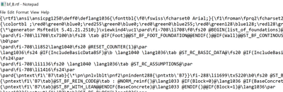

Is it possible to manage numbered headings or to delete this numbering?

biuro.xplan
I make like this, manually so far.
My point is to remove numbering because is useless in this way. But somehow automatically not manually.

okapawal
Which code are you using?
Waldemar Okapa
Sr Product Owner
Message 7 of 12
biuro.xplan
what you mean by "code"?
Message 8 of 12
okapawal
I mean design code: ACI, Eurocode?
Waldemar Okapa
Sr Product Owner
Message 9 of 12
biuro.xplan
Eurocode
Message 10 of 12
okapawal
@biuro.xplan
RC calculation notes are generated out of templates in rtf format.  Each design code has separate templates.  You can edit them (but you really don't want to when you see the content).
Find attached templates for foundation EC design, without numbering.  Three files *.rtf.
Copy original files from "c:\Program Files\Autodesk\Autodesk Robot Structural Analysis Professional 2022\Template\"  to a safe location for reference, if I made a mistake in my edits.
Replace with the attached edited files.  You will need admin right to overwrite files in this folder.
In order to see updated notes, you can rerun calculations.  Or just generate new note with Results > Calculation Note command.
Waldemar Okapa
Sr Product Owner
Message 11 of 12
biuro.xplan
@okapawal thank you. This is what I am looking for.
Unfortunately, when I try to change sth I get an error.
Message 12 of 12
okapawal
Better don't change anything.  The template use variables, conditionals and loops.  It needs to be edited with Notepad...
