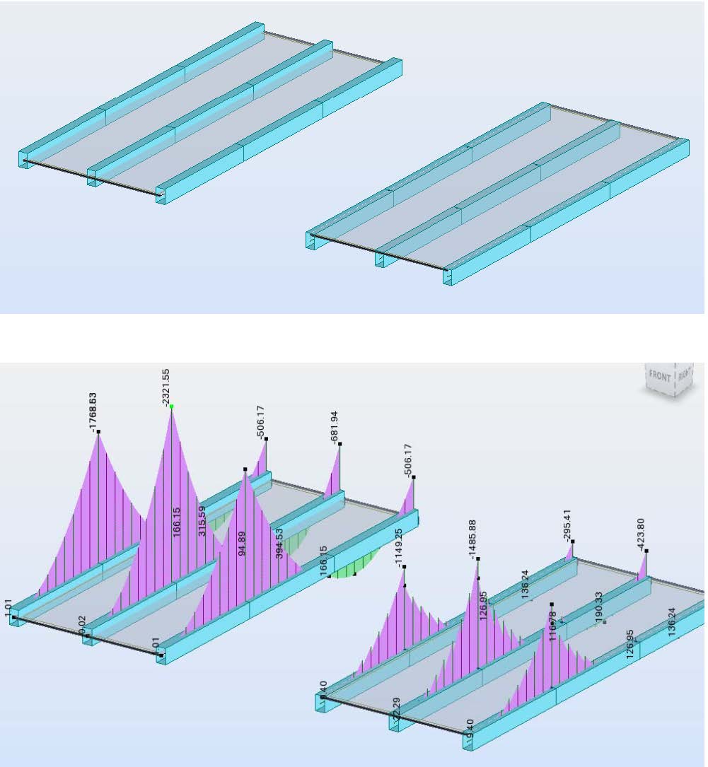

When defining a beam cast integrally with a slab I had initially thought the best way to do it would be to offset the beam down to correctly represent the true stiffness of the system.  However upon seeing the results, I was puzzled as to the "saw tooth" shape of the bending moment diagram in the beams, and alot of membrane force in the slab.
After reading the following post  http://forums.autodesk.com/t5/Autodesk-Robot-Structural/T-slab/m-p/3185418#M915 I thought I would try to follow the solution offered, ie no beam offset.  The bending moment in the beam now looks like I expect.  I created a trial model, a cantilever beam and slab with 2 back spans, all equal length. The only load case is self weight.  See pictures for comparison;
Left is no offset, right is offset to match slab level.  Note saw tooth bending diagram on right.
Membrane force in local x, and panel cut of bending in x direction, overlaid on bending map.
So in the "no offset model" (left), I get peak beam hogging over the first support of 2320kNm, versus only 1485kNm in the centre beam on the right model with offsets.
My question is, which method of modelling produces results which are closer to "reality".  I'm running the same system as a monolithic 3D volumatric element in the background as a comparison.  I'll post stress maps when it finishes running.

Tony,
After reading the topic you refer to you already know what I would try to do Smiley Happy

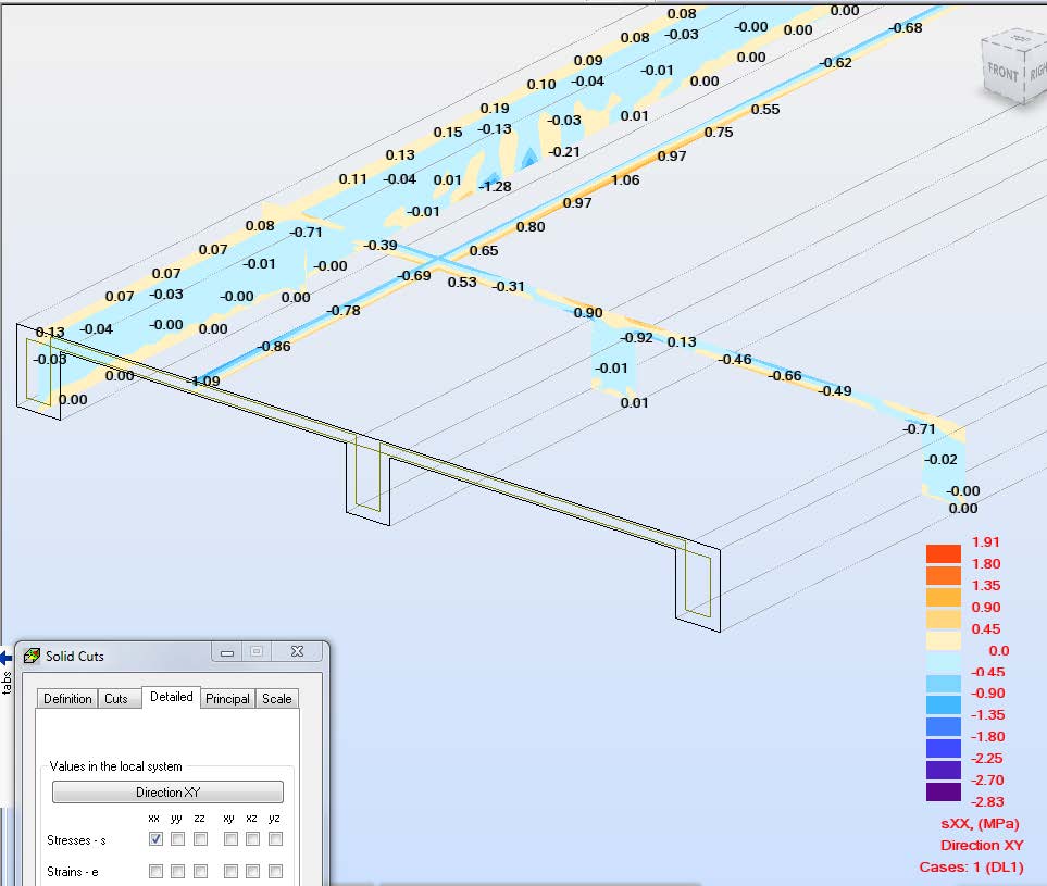

Well, I waited 1/2 an hour for my model to run Smiley Mad and now I have some results from my 3d solid version;
I added 3 solid cuts, one along the edge beam centrline, one across the slab parallel to the beam, and one perpendicular to the beams.
First is x-direction.  You can see that the slab midspan is in tension on the bottom and compression top Smiley Happy

Then y-direction.
The entire slab is in tension all the way back past the first internal support.  This disagrees with my previous post where the membrane force in the panel was zero for no bar offset.
So back to my original point.  I understand that for design of the beams, it's far easier to make the simplification that they do all the work and the slab does none (in the beam span direction), then reinforce the beam accordingly.  However if i was trying to really optimise the system and not reinforce over conservatively, can I assume that the slab takes some of the load in tension / compression.  Is the real kNm value of beam hogging somewhere in between the saw tooth and the idealised "no offset" method, or should I be doing 3d models of everything that take 30 mins to run, and converting stresses into mm2 of reinforcement?
Thanks for your comments!

Tony, I'm sure the slab will take some tension /compression (due to bending) but you should display stresses for the top or bottom layer rather than in plane forces Smiley Happy The in-plane forces for such model with vertical loads and linear static cannot occur in the model (mind that in the solid you have real heights of a slab (and beams)  so that the top and bottom layers 'move' with respect to each other under vertical load whereas surface elements and bars are dimensionless in this 'direction'.

another edit hmmmm,
If I use the peak stresses above the 1st support on the edge beam (just picking rough numbers for this example);
4MPa tension, 12MPa compression.
I assume linear and triangular distribution of the stress in the edge beam (750 wide * 1200 deep) from top to bottom.
From the map it looks as if the zero stress point is somewhere above mid height so I guess 500 down from the top of the slab, (just guessing).....Then I calculate the following;
4MPa x 500mm x 750mm x 0.5 = 750kN
12MPa x 700mm x 750mm x 0.5 = 3150kN
(2/3 x 500mm) x 750kN + (2/3 x 700mm) x 3150kN = 1720kNm.
In my beam and slab model my edge beam had 1780kNm.
Now I'm really confused Smiley Mad

Tony, please mind that the method with the use of  arbitrary increase of beam moment of inertia (the decision what coefficient should be used is opened for discussion) is the approximate method I adopted for myself rather than the exact solution (a solid model Smiley Happy).
The solid model includes effects that are not the part of the shell one (real shapes of beams and slab rather than lines and flat surfaces that influence model deformation). The difference of 3-4 % seems to me the perfect result.

One more idea that I just came to my mind: modeling the slab you 'overlapped' part of the slab with beam ('double cross section') making this part more rigid than it is the the solid model. More rigidity -> larger bending Smiley Happy
