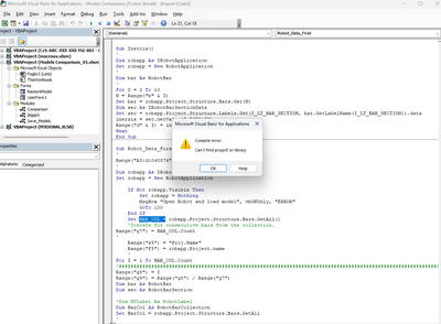

does this work with 2024 version? I've tried it with several models and I only get macro errors if I click to get model data
Message 7 of 12
Stephane.kapetanovic
hi @rokas_varanauskas
Some variable types don't appear to be defined. These are minor changes. Please reach out to the author on their website for an update.

Good Morning,
Probably you've changed you excel installation (version or machine).
Well, to solve your issue you have to add Robot Kernel Object Model in the excel VBA Reference.
To do this you have to:
  1. Open the Excel Spreadsheet;
  2. Press Alt+F11
  4. Then Remove (uncheck) the current Robot Kernel Object Model (That is the old one) and search for Robot Kernel Object Model ver 25.0 (That is the current one) and check it, than click on the "OK" button and the API will work again.

Thanks Stefano! it was indeed missing Reference to Robot Kernel object. For some reason it was looking for ver. 16 but unticking it and then ticking ver.25 as suggested did the trick and macro works again. Thank you for your support.
