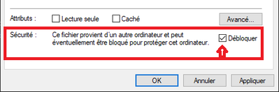

Stephane.kapetanovic
hi @HoshangMustafa
no problem here, are you sure you authorized the workbook macros when you opened it?
After downloading the file from the forum, you sometimes might need to unblock it via its properties to bypass security restrictions.
Best Regards
Stéphane Kapetanovic
don't forget to click the Accept Solution button and leave a < like !
Message 19 of 20
LionelDallenne
Hi @HoshangMustafa,
please make sure as well to unblock the Excel file in the file properties in Explorer.
Best regards,
Message 20 of 20
hi @LionelDallenne
this is not the case it is an excel 97-2003, so no additional blocking
Best regards
