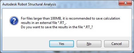

I tried to open using repair model, But i am loosing rebar details i already got for beams. Is there any other option?
Message 7 of 10
Rafal.Gaweda
Autodesk Support
Autodesk Support
I am afraid you answered No on this window.
Repair mode helps only.
Rafal Gaweda
Message 8 of 10
Ohh, Yeah. I select No.
Thanks Rafal
Message 9 of 10
Rafal.Gaweda
Autodesk Support
Autodesk Support
So select always Yes there, in future.
