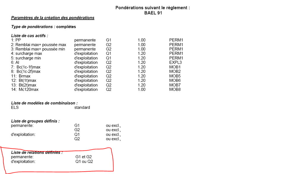

HI Rafal Gaweda,
plz, I need help ...
How to use relations between groups with VBA
PERMANENT "G1" And "G2"
EXPLOITATION "Q1" OR"Q2"
"Definition of relations between groups. Definition of relations between groups can be illustrated by means of the matrix whose elements are group numbers. All groups whose numbers are located in the same matrix row are in the same relation with each other (either AND or AND_OR). Whereas among the matrix rows the relation EXCLUSIVE_OR occurs. ."
How to do relation between "G1" And "G2" with VBA plz
