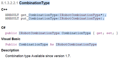

Hi All,
I preparing a script that modifies combination type for selected number of combinations. I have a problem with listing and changing combination type for sls frequent, characteristic etc.
I defined all types of available combinations:
I try to read combination type using following script:

So SLS:CHR, SLS:FRE and SLS:QPR is simplified to SLS 1.
How can I get unique values of those types? API manual mentions for example I_CBT_SLS_EC_FRE = 4 but I have no idea how to read this value.

hi @piglet0
You can find the values ​​of the enumeration IRobotCombinationType on page 429 of the "Robot API 20xx.pdf" available in the \SDK directory.
The CombinationType property is read/write.

Stephane.kapetanovic
Have you selected EN1990 Eurocode standards in the default preferences for design codes?
see also : API - Combination type, Non linear support via API, Different manual combination table, Combinations - Definition / Modification dialog
In any case, certain types of combinations are not accessed or edited in the standard way.
This project is currently underway. I’m preparing a post on combinations and will let you know as soon as it’s ready.
