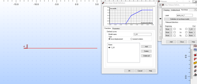

In the example it is applying the non-linear model only at end-node and non-linear function for UX but i think you can get the picture. Sorry for the lazzy code...
The result of this code is something like this:
