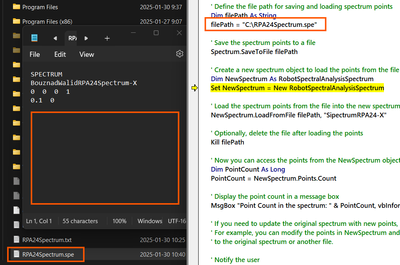

Hello Stephane,
In fact I already know to create new Spectrum, but what I'm trying to do know is just to update only the X Y Direction, and keep the original spectrum as it is.
so my logic is to retrieve all the original spectrum parameter and assign them again to the updated one except the direction (the one i want to update), that's why my old post is not the response I'm looking for.
like you see above I tried to iterate through the point but it seems the API have limitation in this part, and I did also tried to use the (SaveToFile),(LoadFromFile) methods but if fails also the file creating is not having the point unfortunately, that's why for me both method failed.
As you can see in these screenshots
I tried also the .spe , but the same result
here the code

Stephane.kapetanovic

WALIDGIO
yeah, but I'm stuck in the part to retrieve the point from an existing spectrum in the project.
Instead of creating a case, read the one you want to check, save the points and add or transform the file.
hi @WALIDGIO
In the case of spectrum points, since the Get function seem protected, you can try reading the points until the condition is met
      With .Spectrum
        With .Points
          Dim LastPoint As Boolean, x_ As Double, y_ As Double, PtsCount As Long, i As Long: i = 0
          Do
            i = i + 1: .Get i, x_, y_: LastPoint = x_ = -1 And y_ = -1
            If Not LastPoint Then Debug.Print i, x_, y_
          Loop Until LastPoint
          PtsCount = i - 1
