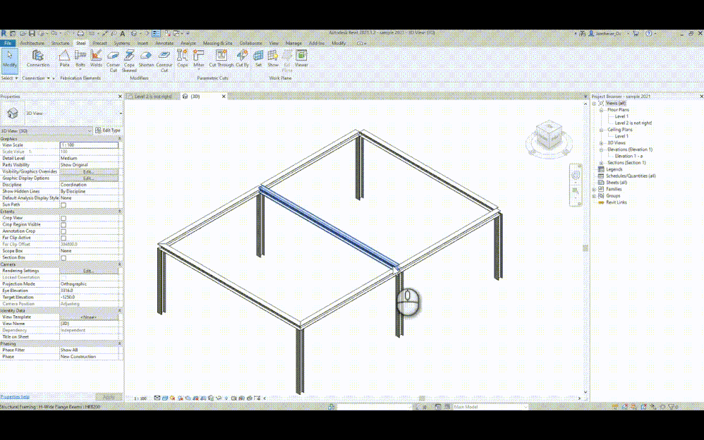

is there any possibility here to control the visibility of the Sub-Connection Category (see pic attached).
I am having the struggle to hide those by element for every single view. Otherwise those elements are causing difficulties in handling the setting of views into the sheets.

It is true that the visibility of the graphics cannot be hidden, an alternative to hiding it is through the phases, see attached file.

z.zecevic
Thanks @Jamhmer_Oc,
that is a cool hint. It´ll solve my problem for now.
Than on the other hand I will need to reorganise all of my phases wich I used to define site excavations, precast delivery study cases etc.
It would be nice if @Anonymous  would incorporate the steel connection tools or any other new tool in the usual revit workflow (regarding visibility options).
I´ll mark it as solved, allthough a workaround button would also be a nice option in this forum.
Thanks again 😉
