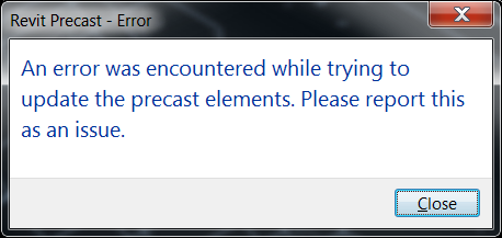

Rab_i
I ran into a problem using Structural Precast Extension for Revit. It impeded with Generic Models I was trying to update fields for. I am attaching few snippet from the Journal in the hope the development team will look into it.
The behavior was, I tried to change parameters in my Generic model family and it wouldn't change. I noticed the lines after the selection command was completed. The Generic model has structural framing family nested.
After I uninstalled the extension the family behavior was restored to normal.

Message 15 of 25
Hi, I had this issue, it needs you to split the slab, make sure the slab is the sam depth as the hollow core ie 200mm  when it has split do not un click ie make sure you dont de selrct it, then go to drawings it worked this way ,, hope it helps  you
kevin
