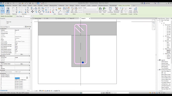

How can I change the hook orientation of the next stirrups and so of the others ?

press the space bar

Yes that spacebar option works but I m asking for the others stirrups lions
which are coming next after the first one , then how can I change the
orientation of next coming stirrups links .
For example : if i have one link placed at one corner then the next one
stirrup hook I want to place in other corner , how can this be done ?

is just to break up the group, and each individual stirrups is deployed

... or then use two sets of stirrups - one set with links on the left side and one on the right side.

do you really need to do that it's very time consuming and not worthy it's a construction issue that is not affecting the BBS or drawings
just write a note on the drawing!

Ohk this thing we can do by making a note

you can use two sets of stirrups
but I think you don't need that in real-world construction since it can be written in the notes
