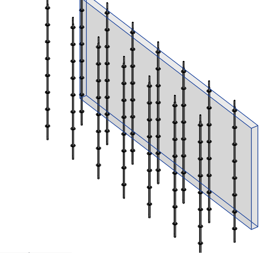

We ended up taking the adaptive component route for our families, and using Dynamo for placement. So far I've only built families for a standard and a rosette, and the Dynamo script is correctly placing the standards based on the face of a selected wall in Revit. We're still going to have the same problem when we get to the corners and any unusual parts, these will have to be modeled piece-by piece, unless we have a family/dynamo that is extremely well put together which has the flexibility to do it. So far using the Revit families, we've done a 100,000 instance test and although it is moderately slow, it's still workable. 5,000 blocks in AutoCAD on the same PC is almost completely unusable (10 minute regen times etc.).

I've designed some scaffolding families in Revit. It took me awhile to create a methodology to make it. It indeed works slowly than AutoCAD but as you mentioned it is much better to create sections and views (detailing in general).
I'm wondering how does work your methodology to build up a scaffold?
I my case I had to create grid lines to places the Jacks and standards, ledgers and braces. And then I created plan every 500mm height to place my ledgers. I used a lookup table to create the ledgers family, therefore if the bays change the size, all the ledgers change too and its description. The only annoying thing about this process is if the ledger length is not spot on, it does go to the schedule as unknown element.
