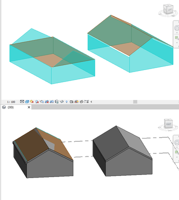

Hi
I tried to model my roof as a structural floor because I want to view the analytical model of my roof.
But The analytical model of the roof is not inclined but it is straight ahead as you can see in the photos.
How I can resolve it? Thank you so much

Message 8 of 8
These photos are more clear:
