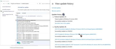

We have some users that are unable to find the update in the list of programs.  See image below:
The update is showing in the update history, however not showing in the installed files list.
Do you know about this issue and how to resolve?
