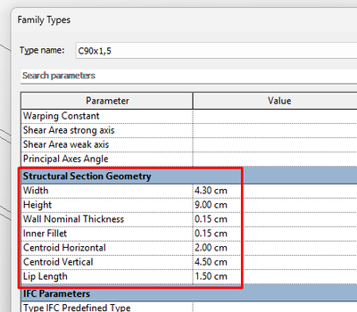

I'm also interested in adding this type of section in Revit, but I haven’t been able to do it following the instructions in the provided links.
Let me explain what I did:
- I added a beam;
- Opened the structural framing family in the Family Editor and changed the Section Shape;
- Opened the Properties panel → Family Types.
At this point, I expected to find the parameters related to the new Section Shape under the "Dimensions" category, but the parameters shown are still from the previous section type.
However, further down in the same window, I do see the parameters for the new Section Shape.
After clicking Apply and OK, nothing changes.
I’d like to know the correct way to proceed.
