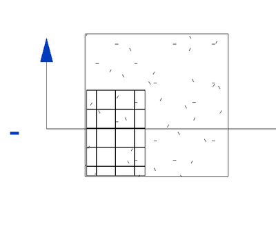

Single footing of dimensions 3,50m x 3,50m needs to be reinforced with wire mesh (upper layer).
The way I would like to reinforce this footing with mesh (standard dimension 6,0mx2,20m) is by making pieces of dimension 2,20x3,0m and 2,20x1,0m + 2,20x2,0 and 2,2x2,0 with 0,50 overlap in each direction. Here is the sketch explaining my question. So, is it possible to make custom pieces of standard wire mesh without making new types within existing family?
In addition, please pay attention to overlaps in both direction - there must not 4 meshes overlap in one place, only 3 or 2 is allowed. What can I do, when making my shop drawings in Revit, to respect that rule?

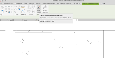

This makes more sense now it has been explained and it is known it does not necessarily relate to Fabric Areas.  Unfortunately you cannot place Fabric Reinforcement in Structural Foundations so unless you use slabs you cannot use Fabric Area Tools!
You could use Structural Foundations and in Section or Elevation utilise the Fabric Sheet > Bend Sketch Tool and place it without a Bend

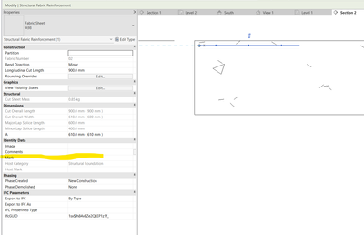

From here you can control the Width (A) and Length (Longitudinal Cut Length) and arrange your Fabric Sheets to the exact sizes specified without creating new families
As regards Mark References you can manually assign a Mark to a sheet so it could be refenced as a single sheet of many parts with all the Same Mark

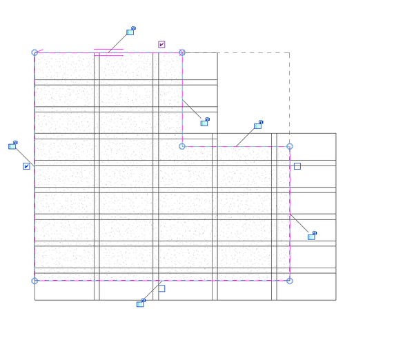

If you did want to use Slabs and Fabric Areas you would need to create Duplicate Fabric Sheet Families to the sizes you require place using Fabric Area and manipulate the layout to Suit (No more than 4 overlaps as shown below) > Remove the Fabric Area and change the Fabric for the exact sizes as required.
