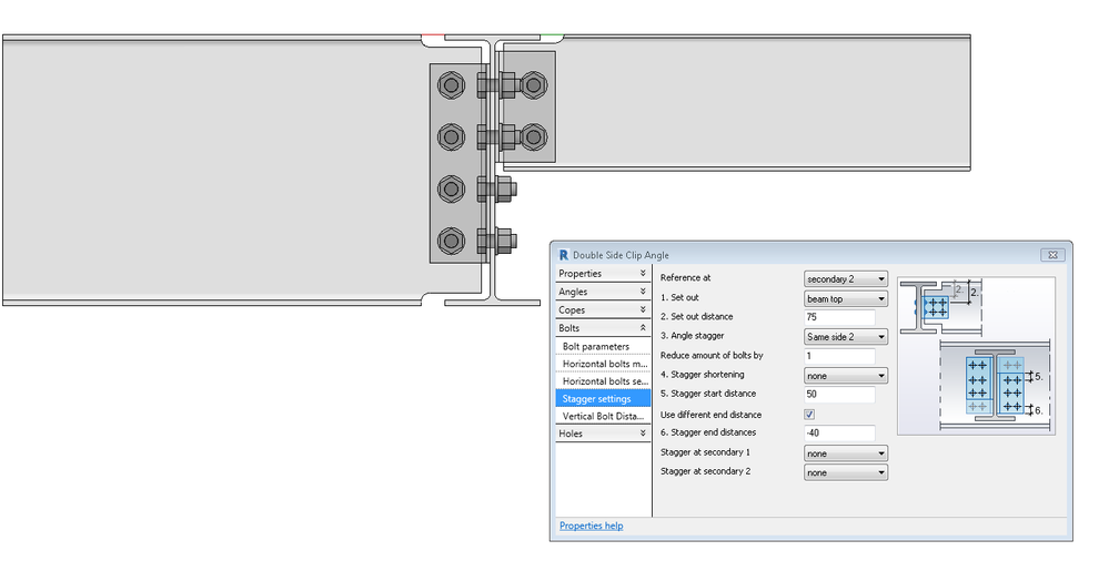

I am starting to dig into Revit 2019 Structural and the provided connection details. I would really like to be able to model all the detailed connection in Revit and then move to Advance Steel for the detailing, but I can't even get beyond 1st base with a simple beam to beam connection (See attachment). I believe I am following the correct steps in making this connection (Double Sided Clip Angle) and it appears Revit programming can't figure out how to correctly make this connection. It looks like a good start but the smaller beam is not coped correctly and has an incorrect clip angle bolt qty. Is it true that you have to manually modify every connection? Does anyone know of a good tutorial on making basic clip angle and splice plate connections?

The default parameters for each connection does not take into count the input elements.
You need to modify each instance.
For your case of Double Side Clip Angle you can do something like this:
If you want to keep the connection settings in order to re-use the configuration:
- select the connection
- From Modify | Structural Connections tab >Connection panel select Customize
- save it as a custom connection
- re-use the custom connection in other situations
From the custom connection editor you will be able to edit the Double Side Clip angle settings and all the changes wil be propagated to all the instances of that custom connection. Also, the custom connection can be transfered to other projects.

I did play around with the connection and was able to get the connection to look properly. It is unfortunate that every connection needs to be tweaked.  It would be a better idea if the programmers provided a way to save a connection assembly and apply it where needed. Can these connections be copied from one location to another?

I just used the customize routine and saved a connection and applied it at a new location. It worked great but for some very odd reason it created another beam off in space.. see attached screen capture. Ughh...

When I created the customized connection, I must have inadvertently selected a near by beam. My bad.. I deleted the saved connection and recreated it with no issues.
