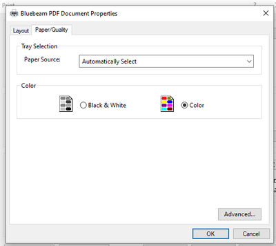

so we model in colour but we print in black but is there a way to have the just revision clouds print in colour? (see images below)

francfiles
You can easily print title block logos in colour by setting your PDF to colour. lgogs will print in color even if your printer setup is set to black lines
