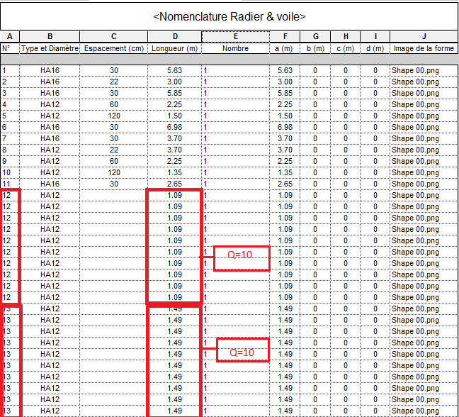

Hi All,
Hi @ovidiu_paunescu
In my project I want to count variable rebars's set these have a same number and length and group them in a single line in the schedule, as shown in the picture bellow
In my example bellow, I want put in schedule for rebars:
number 12:  (by element =10 ; elements = 1; Total elements = 10)
 number 13:  (by element =10 ; elements = 1; Total elements = 10)
How can I do that?
Thanks.

What you want to do is use grouping (on the grouping and sorting tab of the schedule).
And if you want summation of the grouped elements, on the formatting tab you can set calculate totals for each of the fields you want to have summed up.
See THIS site with some explanations how to set things up

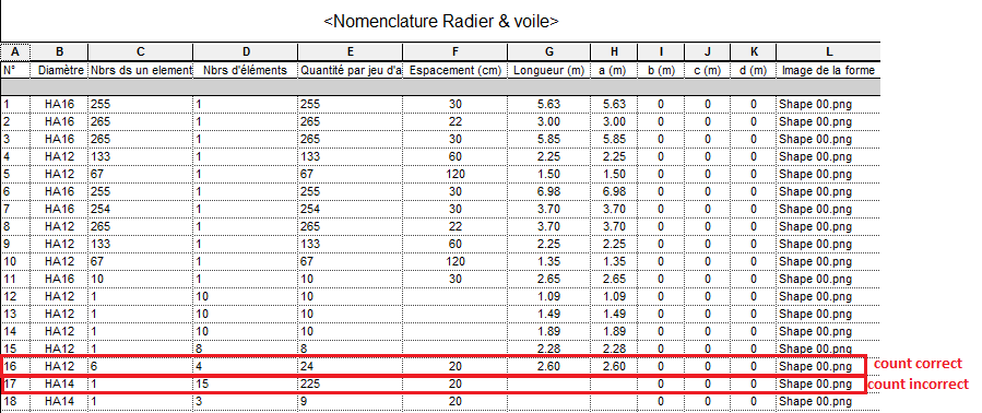

finally, I managed to group the variable rebars having the same length and the same number in a single line by unchecking Itemize every instance but I still have problem to calculate the total rebars count for each of them
see image bellow:
for exemple: N° 16 : Total count is: 6 x 4 =24 and that is correct
but for N° 17: count should be 1 x 15 = 15 not 225!!!???
how to solve that?
Thanks.

I don't understand how REVIT calculates the total count of rebars with variable lengths in the same set!!!... I noticed that REVIT uses a square function to calculate the count of  these rebars and that is wrong!!
All counts of my rebars having variable lengths are false!! (see schedule bellow)
for example in the image bellow , the count of rebar N°17 should be 15 not 225!!! ( Note: L = 64.45m is the sum lengths of 15 rebars)
please check the portion of my attached file bellow to find a solution to my problem

Format > Quantity of Rebar Set > No Calculation

Count is a schedule field that counts the number of elements. You shouldn't use count for rebar as the bars inside a varying set are sub-elements.
For this you can use quantity which is equal to 1. If you want to show the entire quantity of bars in a varying or uniform set, you can use quantity by rebar set.
If you are numbering the varying set individually (each bar gets a rebar number), the regular sorting and grouping would work.
So you can add the following fields:
  • Rebar Number
  • Quantity
  • Bar Length
Then you need to:
  • Sort by Rebar Number
  • Uncheck itemize
  • Set quantity to Calculate totals
  • Set Bar Length to calculate totals
  • Add mass / m and compute the weight of each group of bars
