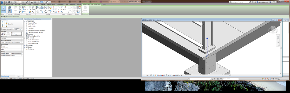

Hi! I hope someone could help me on this.
Im trying to make a baseplate connection between a column and a footing (image 1) whit the add-in structural steel connections.
My problema begins when i click on the connection button and select  the 2 parts  for the connection because after waiting severas seconds i can see any geometry or warnings (like on the image 2).
Then when i change the primary element for the connection by clicking on the little blue circle it show up for some seconds the geometry i need (image 3), but past few secondse it desapears and show a warning saying "connection creation failed" (imege 4).
Does someone got that problem?
PD. If i Use just the column for the connection it just not appear any geometry or warnings at all, but Still can use the button for "modify parameters"

Message 2 of 12
Taweepong.S
Hi ,
Please give me for more information of this case ,
What's your column steel section ?
Regard ,
Taweepong S.

hayley85
I have the same problem.
After choosing the component, then clicking on Connection , I received the error warning connection creation failed.JPG
Please help !!

Message 6 of 12
catalin_lang
In the first case, when the column is the main element for the connection, are you sure the connection is not "hiding" in the foundation block?
The base plate connection is created at the column edge, without taking into count the foundation position
I look forward to your response,
Regards
catalin.lang

laverdadozharalibres
Regards
Yes i tryed on an isolated column whit same results
Message 9 of 12
hayley85
Many thanks Taweepong and Catalin !
I was using "certified families " in US metric with those errors. Then I tried to switch to use the libery to European specific and seems like it's running now.
Cheers
Hayley.
