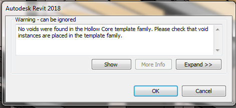

I have loaded the family that I created to the folder, I choosed the family in the Configuration menu.
now I have this error
Message 8 of 24
jeroen_vanmassenhove
Under Configuration in the Precast tab, in the tree on the left, go to Precast > Concrete > Slab > Hollwcore Slab > Segmentation
There, you can see 'Minimum Width', you can change that to be very small, so your hollowcores get generated.

Message 12 of 24
teodorb
Hi @Anonymous,
I has a look at your family and here are some things that you should make sure you have for the Hollow Core Slab.
The voids have to be independent (you have defined you void as a single item containing multiple skethces) -  you should define the void separately ( http://help.autodesk.com/view/RVT/2018/ENU/?guid=GUID-4603E42A-C22F-4D26-8295-D9925A9DD432) and make sure you you save where the family is situates the voids (e.g. C:\ProgramData\Autodesk\Structural Precast for Revit 2018\Families\en\Custom Slabs)
After you have completed the void, you should add it to the template by following this rules: http://help.autodesk.com/view/RVT/2018/ENU/?guid=GUID-E7D7E68A-7794-4458-A691-A1798733D2B2
For the template please draw just a rectangle, as the profiles have to be defined like here: http://help.autodesk.com/view/RVT/2018/ENU/?guid=GUID-ED92BA19-026D-46A9-9E1F-851536B0E07B and should be saved here: C:\ProgramData\Autodesk\Structural Precast for Revit 2018\Families\en\Profiles
Let me know if you need further assistance.
Kind regards,
Bogdan Teodorescu
Product Owner

teodorb
Hi @Anonymous,
You need to have the void (in your case LHD20 void 02_05_2018.rfa) at the same location as the hollow core template (C:\ProgramData\Autodesk\Structural Precast for Revit 2018\Families\en\Custom Slabs). After i saved the void family and the hollow core slab template at this location I managed to obtain the desired result. I have attached the Revit file.
Kind regards,
Bogdan Teodorescu
Product Owner
