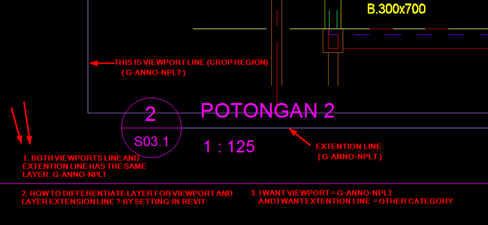

I always export revit sheets to .dwg file.
But why after exporting them to dwg file, Extension Line of View Title can't be printed because of having different layer.
Because of this problem I must do "matchprop" every view title in dwg, everytime after getting revision, and it takes very time consuming.
How to make the Extension Line of View Title in revit AUTOMATICALLY able to be printed, and i dont need to matchprop everytime ???
you can see this screenshot:
Image-1 (On revit sheet)
Image-2 (after exported to dwg file)
Image-3 (after exported to dwg file)

walidinJKACC
I follow your instruction to remove -NPLT, but now the problem is that viewport line also appears when printed to real paper or pdf.
See this pdf screenshot after exported to dwg from revit as test to real paper.

walidinJKACC
@virgilio_benedictos
1. extention line doesnt appear as default in family environtment, but in sheet view it always appears. how this can occur?
2. How to differentiate layer for viewport and extension line  by setting in revit
