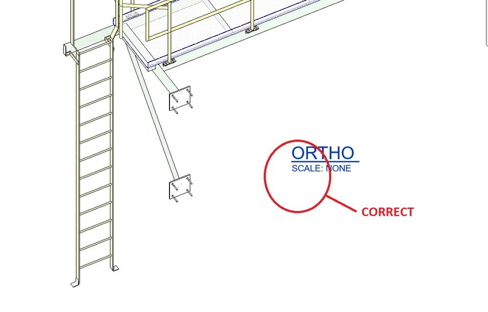

Was all exited that for once I might be able to print 10 sheets without having to sit there and put in the correct pdf name for each and every darn sheet.  Used the exprort to PDF with sheet number as the namaing parameter,  thought it all worked out fine until we scrutinized the prints (see images).  Printing to PDF no problems,  just the annoyance of having to type each sheet name as the prints complete.
The result form print to PDF
The result from Export to PDF
