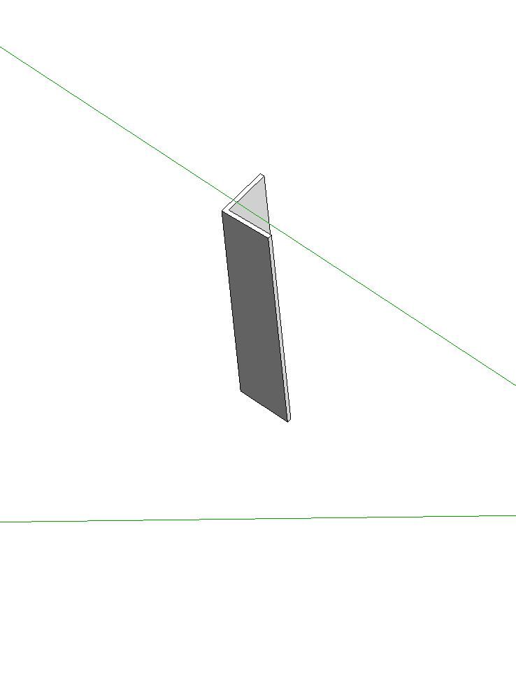

Does anyone know how to change the orientation for angles I've tried changing the reference plan angles etc
I am trying to get my angles like the third screenshot.B.JPGc.JPGbracing.JPG

As stated I am trying to align my angles to be like the first picture shown. However it is coming vertical up when orientated through the structural brace system  (when creating). Tried doing it regular through the just placing the beam but as a angle and it is no where to be found I've made sure that the category is turned on which it is. I've search through the model but can't find the angle. ]
I have tried your 3D snapping however I still get the same orientation as shown in picture two the only way I resolved my problem was copying a angle from a old project and placing it in my plan view which had the correct orientationbracing.JPGB.JPG.

I have replaced what you said to 0 however the angle still coming in wrong same if I try to create a line its just going to the wrong orientation.
