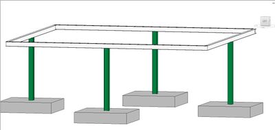

I have Revit 2017, and I need a UB connected to the UC using a cap plate. But there's no option of cap plates and I've tried using end plates connections but they cut my beam in half. What can I do?

You can model a steel connections between the beam and the column using the following 2 connection types:
- Gable wall end plate
- Moment end plate

When I try this it cuts my beam in half.  Not sure what I am doing wrong, is there a youtube video or set by set instructions available?
SOLVED!!!  You must select the beam as the primary element in a Structural Connection.
