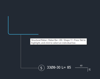

Hi everyone,
does anyone know why Revit does this?:
Mirroring or changing the parameters also isn't an option as the shape gets mirrored as well + it would even be a bad workflow to model the rebars and then mirror everything.

jay_colcombe
Not 100% if I am on Page here, but place using Space so it was on the Left (as I know it needs to be flipped)
Then changed the Angle to 180 degrees

semi
This seems to workn but then I need to switch my entire detail to the left side:

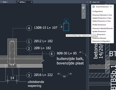

semi
btw: also take a look at shape 51: it's flat
My engineering company won't like this.
I was super excited to finally get to use the bending details, but it turns out to be a major disappointment
Message 5 of 11
jay_colcombe
This is what I see for Shape Code 51?

semi
Sorry if not being so clear.
Message 7 of 11
jay_colcombe
If you asking why it does not automatically come in a Vertically alignment automatically for Schematic Detail I can only assume there is something in the background driving this?
As Orientation > Model should do this but by providing the other Orientation and Rotation Settings you can achieve the result you need but not automatically so maybe something you can raise with the developers.
