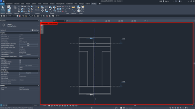

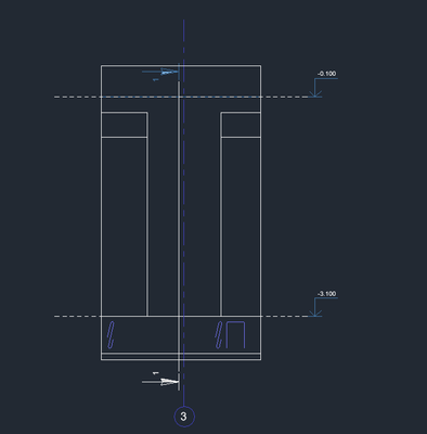

hello,
I'm having trouble correctly diplaying concrete beam/column join in sections.

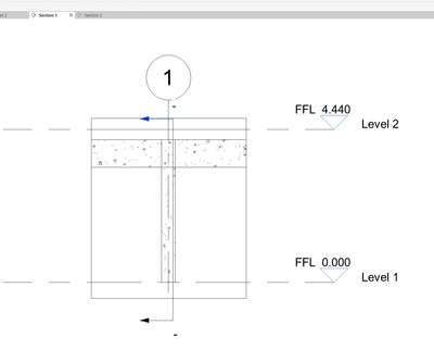

In section 1 columns properly join the slab, but in section 5 beams and columns join, while slab is seperate. It seems like a simple fix but i can't get switching join to fix it.
Is there a way to display column in section 5 the same way as section 1?

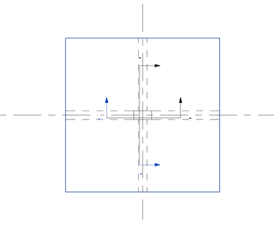

Thank you for your responce, unfortunately i can't fix the view. Both views are on the same column with same view template, same material.

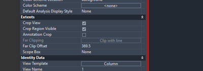

Hi something does not look right here and the only defining difference between the 2 sections is the Far Clip Offset in Section 1
Creating a similar scenario in a Structural Template you can see my beams are more uniform in the dashes coming into the column where yours are not do they go over the top of the column rather than meet at it??
But you can overcome them by using Switch Join Order between the Beams and the Column in Section 5
