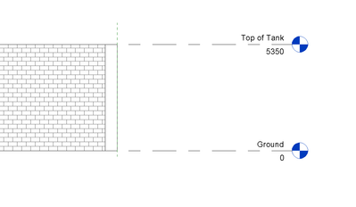

how high is your tank? can we see the section?
Message 10 of 21
tmccar
Here it is:

You have to put a negative value on this (see image) to see the walls below.

Message 14 of 21
tmccar
Ok, when I used the negative value (-1) it worked.
But I would like to know why it needs a negative value. Does that mean that, if your view is on Level 1, it will not show items on level 1? In other words, it will not show the items unless you are "cutting through them" - like a section?
Message 15 of 21
deshmukhnavid
Your Items are not at level 1 those are below the level 1 , that's why u need to lower the view depth plane to see items below level.
