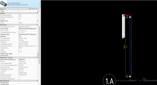

Hello, good afternoon, I have a question I'm wondering. how can we see the flow rate through the pipes in revit 2021 heating systems? without magicad. gonderdigim fotograf revit 2019 is also a drawing learned by registering an account with magicad. can I do this without magicad?
 how can I show the flow rate I wrote on the radiator on the pipes?
what kind of parameter should I use?

Of course you can have the flow rates in pipes. You don't need MagiCAD for that.
Just model your network with the pipes and the mechanical equipment (i.e. radiators) and use the "Duct/Pipe Sizing" tool.
Any well formed hydronic network without disconnects will show the flow rates generated by radiators in every pipe segment, first via System Inspector, and then if you wish you can also tag the pipes with the flow rates.

can you explain it with a picture or video?
dyp4f
in reply to: furkanbuharikeskin
Yes sure.
Look below at a screenshot showing a simple hydronic supply/return pipe network connecting some radiators.
I prepared this quickly using pipe Analytical Connections and an OOTB Radiator family.
