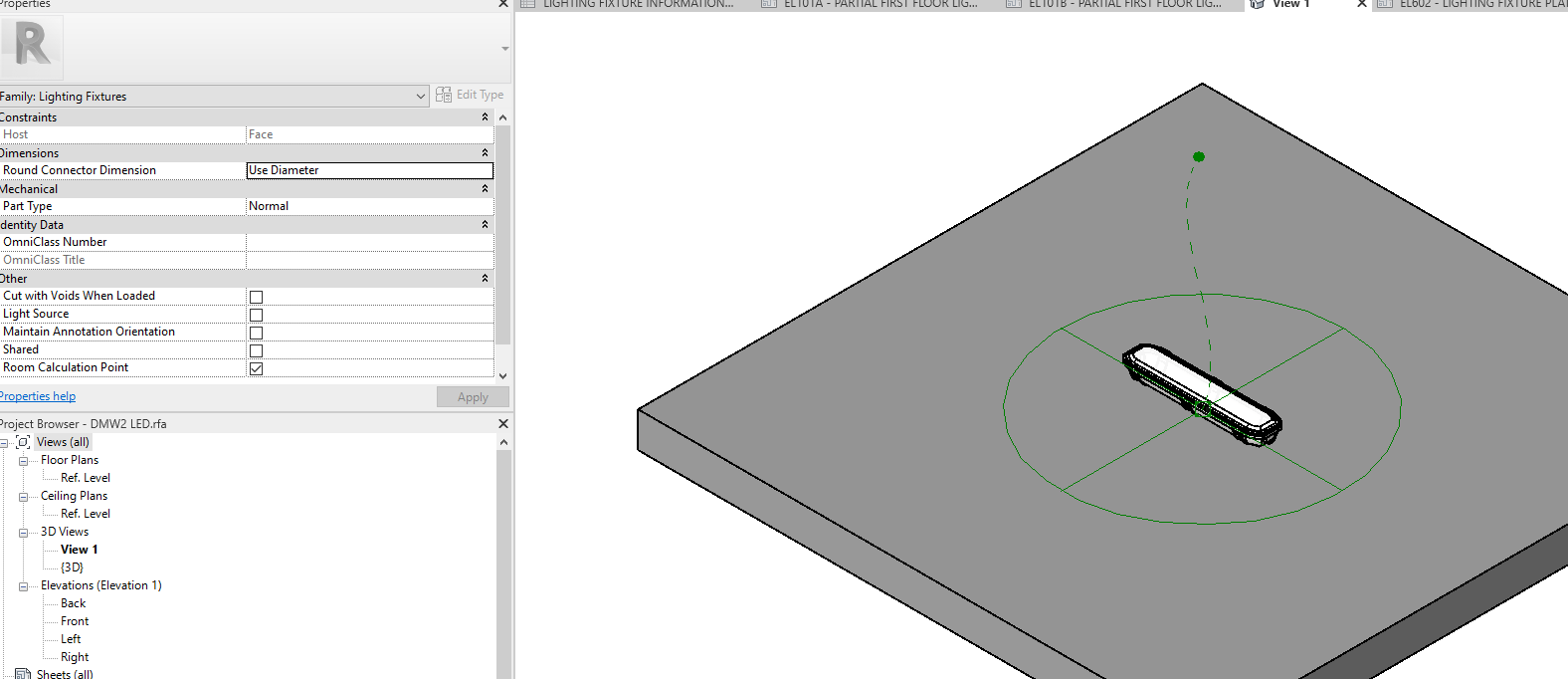

     I am working on a project that has varying mounting heights for the same fixtures throughout many rooms, so I figured I would make a schedule to show the type mark, the elevation, and then either the room number or name that the light is placed in. I have the first two, but I am having trouble finding a way to get the room information as well from the linked architecture model. This schedule is just going to be reference material to help me along with finding the lights that need sheet note references quicker, so not a big deal if this is not possible. Any help would be greatly appreciated.

I can't remember exactly what it's called but there's something like a room point that can be added to families.
Rob
Message 5 of 21
sragan
yes, there is a room point you can move if you edit the family.

it looks like the lights just aren't in the room.  I think the spaces default to an 8' height, and your fixtures are higher.  So you either need to make sure the rooms and spaces are maybe 13' or 14' tall, or you need to edit the light fixture family, and select the "Room Calculation Point", and drag it about 5' lower than the light.  (This can be tricky sometimes because sometimes the lights get inverted so they are inserted upside down, so make sure you drag the point the right direction.

I do have the room calculation point turned on and I even dragged it way down as you suggested, but still no change in the schedule.
