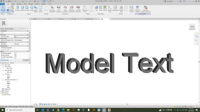

Hi how to match the Chinese type style? The Chinese words style are not match with design...

Did you copy paste the characters?
If so check that the source was saved as unicode.

You need the assign the correct font that the Revit text style.

Yes I copy from Cad and paste it. But how to save it to Unicode?

I looked others project file, someone can done it and I typo correctly, but I don't know how to make it in mine file.
And seem English "Text" the "t" is so strange. Not smooth?
fabiosato
When you try to make the font size too small, it will get some distortions.
