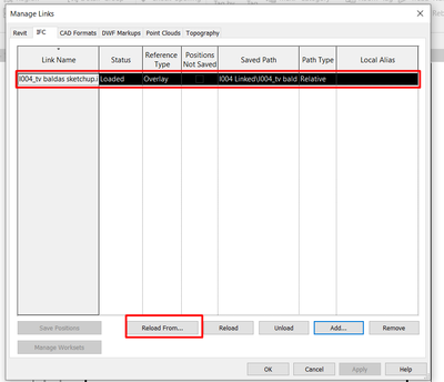

vkulikajevas
I am surprised that no one answered this question yet, but here is the solution:
I have imported Sketchup IFC file into Revit with a LINK, and when I gave my project to other user (copied files), she couldn't reload it because you need to reload the IFC sketchup file instead of revit (project file with the same name).
Please accepts as solution if it helped so others can see.
