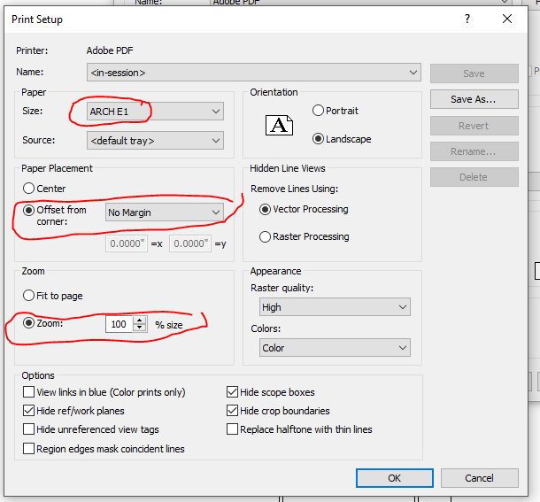

Revit schedules: In an AutoDESK tutorial post the instructor said: "You cannot split a schedule across multiple sheets". But I need to do just that. Specifically a large room schedule. We are facility planners and this is our bread & butter. The attached screenshot .pdf shows my problem. We print nearly exclusively on 11x17. How can I get either the schedule itself to "split" and thus go onto several sheets? Or; change the way the schedule is created to be able to place it on multiple sheets? I am a rather new user, self taught and currently using Revit 2018.2

Example if you need to put one schedule on two sheets without using filters to create two different schedules.
- Drag schedule from browser onto Sheet 1
- Split schedule to two columns
- Drag column 1 to the correct position
- Drag column 2 to outside of the sheet border, on the right side, the bottom of the column must not lower than the bottom of the border.
- Drag schedule from browser onto Sheet 2
- Drag column 2 to the correct position
- Drag column 1 to outside of the sheet border, on the right side, the bottom of the column must not lower than the bottom of the border.
When you print 100% to the correct sheet size + offset corner @0,0 (do not use Center), anything outside, to the right, above the bottom of the sheet border won't print.

Message 4 of 15
Make sure you select the correct page size and the print settings like below:
Message 5 of 15
Thank you!
This was somewhat cumbersome but eventually got me there. Printing the 1st sheet goes exactly the way as described. But printing the information on sheet 2 (or more) means having to create a copy in Revit and saving each sheet-ed version as a separate copy and printing as shown in the attachment. This prohibits printing sheets all-in-one-go, but is better than I was able to do previously.

gnarkill283
This isn't working even with the printing settings you mention - I don't know where 0,0 is on the sheet though - its printing the columns of the schedule that are outside the titleblock
Message 11 of 15
Show me the sheet zoomed extent and your print settings.
Message 12 of 15
gnarkill283
Nvm I just figured out that it will print anything to the left or below the titleblock. So I guess you have to duplicate the schedule for each sheet and move what you don't want to see up or to the right of the titleblock
