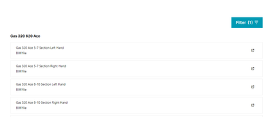

"I think should be considered is the fact that a real product does not mirror, it can be designed in multiple configurations"
That is what I said - if there is a left and right handed version of a product then there should be different versions of the family or different types within the family.
"where a lot of members are working, it becomes very complex and unreliable, just to imagine that the members are not mirroring families"
I don't think you can expect Revit, or any other software, from preventing users from doing things that they shouldn't do. There is no substitute for competent personnel.
Blocks in Autocad would have the same limitation.
"At the end will result in a model with hundreds of families, and not being able to predict if the families are the original (as designed from manufacturer) or a mirrored one."
Same response as previous paragraph.
"in my case I am considering only mirroring a family inside a project instead of modifying the family"
That is a modification.
Moreover what you are suggesting in your initial post is that the some parts of the family should mirror, but other parts shouldn't? - that would be even more of a modification and how would Revit possibly know which parts to mirror and which parts to not mirror?
Again it sounds to me that what you need to do is find or make different versions of families for left and right handed versions of equipment.
Here's an example from a product which I've used in the past:
