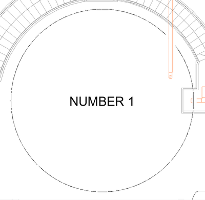

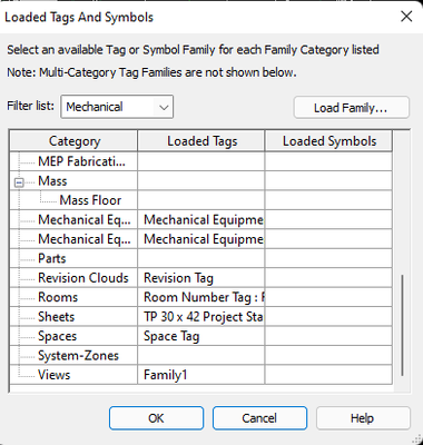

iainsavage_1-1643982819841.pngiainsavage_2-1643982975902.pngiainsavage_3-1643983009089.png
Or, again in your project, you can change the parameter value in the family's properties.
The dialogue box that you've shared looks like you are in the family editor rather than populating parameter values in your project.

Go to the tags & see what tag your using. you can check the family to see if it's pulling from the right parameter also.
