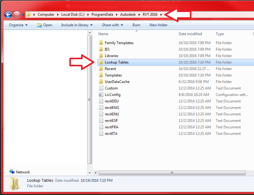

I have revit 2016 and I have big problem
pipe fitting especially elbow doesnt respond to size chang and doesnt raise its size, i dont have revit.ini on my PC , please help me

Hi @elham.calm
Hope your well.
The Default Lookup Tables can be found under: (Copy and Paste the text below and follow the instructions below)
C:\ProgramData\Autodesk\RVT 2016   (default directory destination)
Past the directory which I provided above in an explorer window as shown above.
This will open the following folders as shown below:
That would be the first step, to locate or save your lookup tables in the correct location.
Next, you would have to check to see if your Revit.ini file is referring correctly to your lookup tables.
Can you see the UserDataCache Folder in the image above? Your Revit.ini file is located in that folder.
Do you know where to find lookup tables within a family?
Your using Revit 2016, so that means that the you'll have access to Pipe Fittings under your Libraries Folder as per my second image.
When you load and fitting into your project (just to explain this), click on Edit Family >> click on the Family Types icon under Modify >> Properties.
This will open the Family Types, to the bottom right of the window that opens, you'll notice the Lookup Tables >> Manage... Button.
Click on it to open the window which you'll see to the right below, there is and Import... Button which can be used to load the appropriate lookup table for the connector/fitting.
I also attached the default Lookup Tables for Revit 2016 if you're struggling to locate yours.
I hope this helps! Smiley Happy
