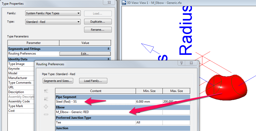

Ok, had some time for the issue with the realistic view. In that case you can take the following approach. For your pipes you use certain segments (e.g steel). In the MEP settings you can duplicate these segments and then use a different material for each of them. For example I created segements coloured green, red and yellow.
For your pipe types you select the type you normally use and duplicate them for the different colours.
Then you change the routing preferneces and select the different pipe segments. You also need the modify your pipe fittings to include a material parameter. You also select the right colour fittings in your routing preferences.
In your project you draw your pipes. If you need different colour pipe, you select pipe type with different colour.
From screenshot above you see can that this will work in shaded as in realistic views.
Above process will take some time to set up if you use lots of different fittings and pipe segments in your projects. But once done you can make it part of your project template and reuse it every time.
Attached the example file in Revit 2015
