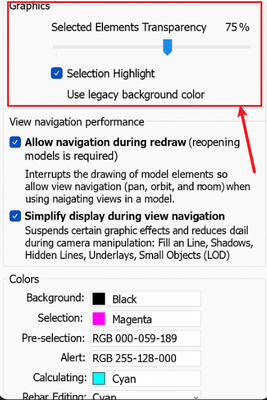

I want to achieve increased transparency for selected elements in Revit (so they appear more see-through when selected). I’ve seen that in newer versions there is a “Selected Elements Transparency” slider in the Options → Graphics settings, but I cannot find this option in Revit 2021–2024.
Is this feature available in these versions, or is there any workaround to make selected elements more transparent?

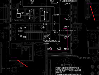

This example demonstrates the visibility level of the selected elements and the challenge in distinguishing them clearly.

Not sure what this screenshot is supposed to convey - are you saying that they are too transparent? If so why don't you just disable the "semi-transparent" option?
You can also alter the colour for selected objects.
I also find things to be much clearer when the background is white rather than black (also that's what it would be like on paper).
Semi-transparent active:
Semi-transparent disabled:
Choose a colour to your preference for selected objects:
Looks like you have chosen dark grey on a black background with semi-transparency? Maybe not the best option.

I don't prefer white because it's straining on the eyes and feels uncomfortable to me

The default colour for the dark theme is a light blue/cyan which would stand out more than whatever you have chosen:
